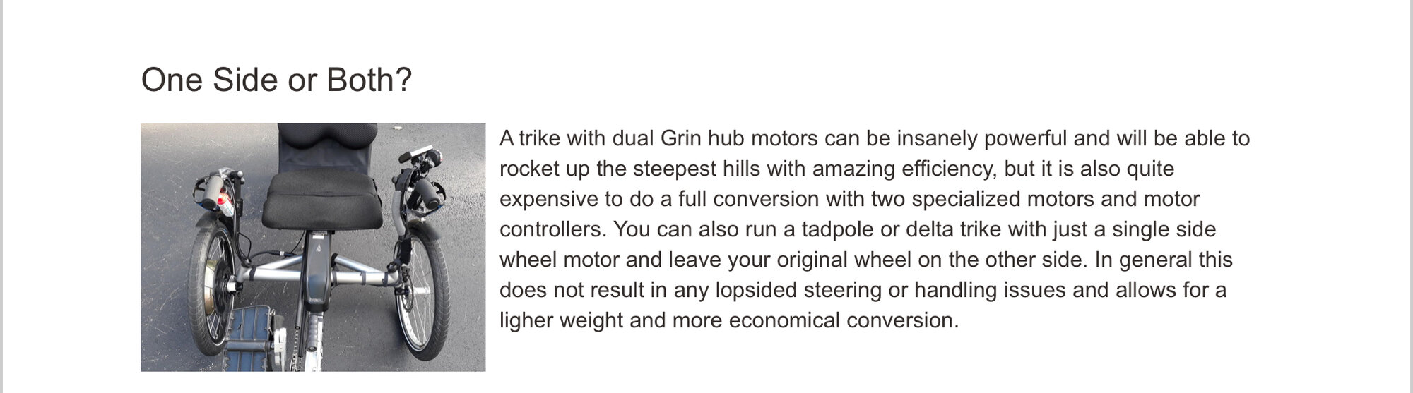

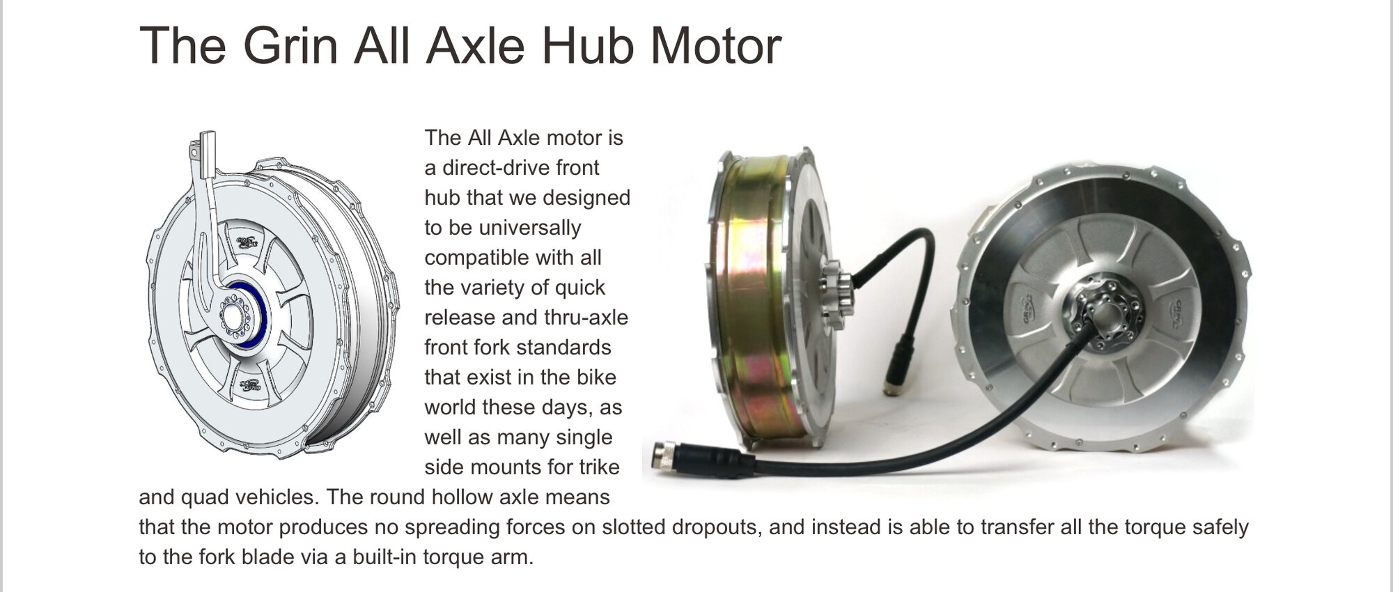

@Bigjayvapes seriously you are well into the territory where a 2wd solution - 3wd in your case - makes a lot of practical sense. Honestly as I said earlier, making this happen with a single-speed is a tall order. I don't know where you are going to get a big enough rear cog for this. White Industries is where I'd go for one and the biggest they make is 22T. Thats well underneath what I'd be comfortable with and a second motor helping out might be the ticket to make it work (OR give in and put a derailleur on... which has to be cheaper, easier conversion than going 2wd). Give it some thought. Here are some details on the concept. There are fairly detailed build writeups here as well.

Most trikes only drive one wheel. It is like driving a tank with only the right tread. This makes handling weird. Trikes with a differential are very expensive and probably only available in Germany and Holland. Although some industrial trikes will have them if they are good.
m@Robertson
This one has a diff. I remember the review and being surprised.
Also evelo makes one with a diff as well.
if the trike doesn't have a diff, then you have to use a front motor... and that means you can't get there from here with that trike, I think.

Next year I have a 200 mile round trip ride, a few of them planned I'm going to put a 1000w front motor on for now, during next winter I'll get the 1000w mid drive motor put on for my 600 mile round trip ride, that way I can split up the cost and not make my wife mad.😊

Sadly I pooched my new build budget when i bought a second trike, Day6 joy, when the Husky proved to be a dud. If I hadnt I think I’d spend the dollars on dual rear motors. But then I am a Grin fanboy.
